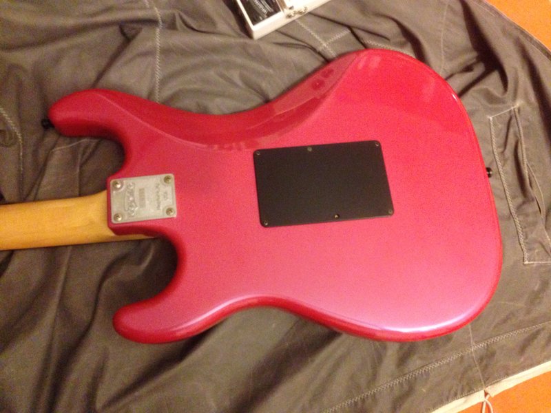

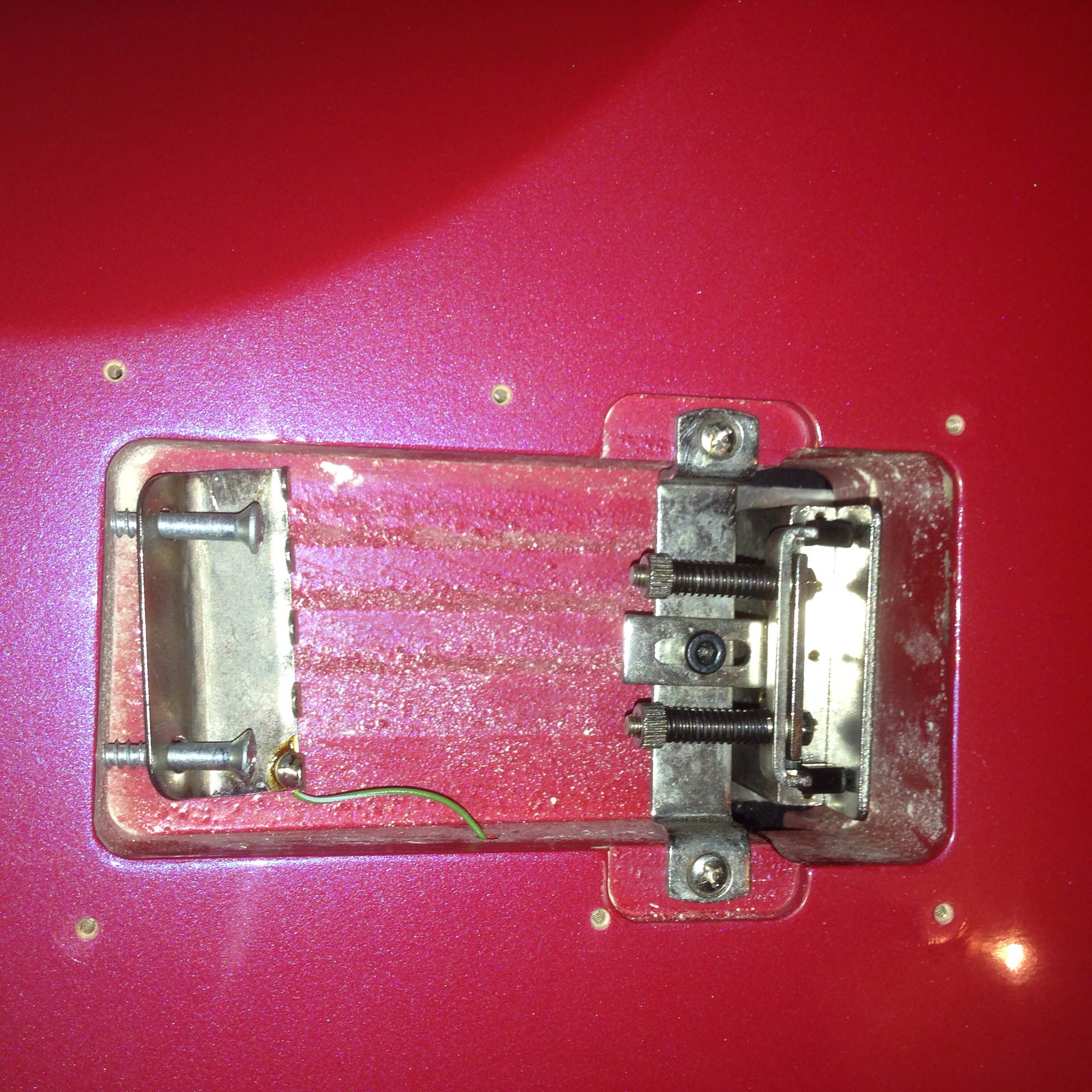

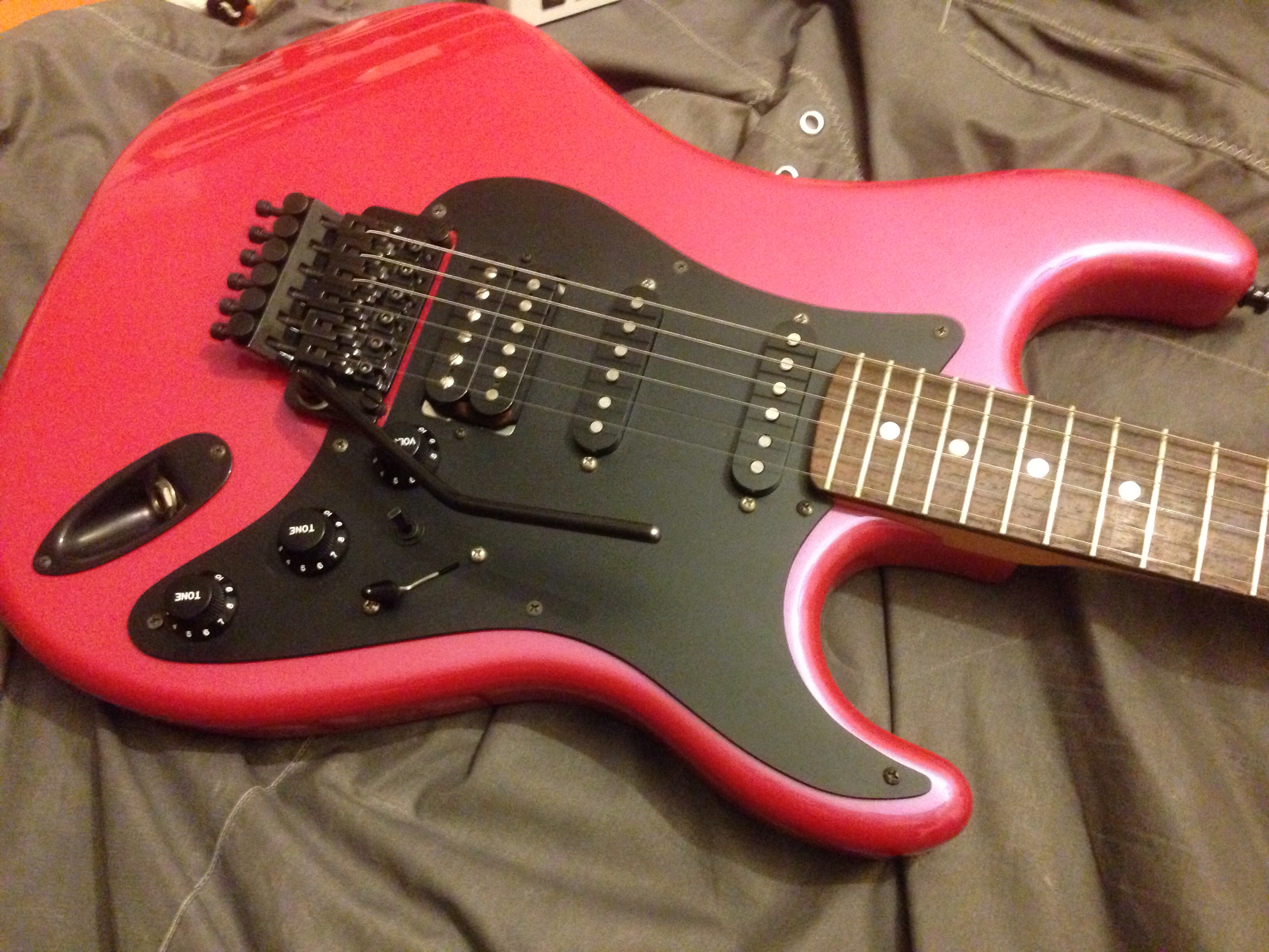

I found a nice Kramer Pacer Deluxe, 1988, bought in San Francisco at the time. The guitar needs some cleaning (electronics, screws). The body and the neck are in a very good condition.
The Floyd made some strange spring noises as I tried it. When I opened the back of the guitar, I discovered that stabilizer I never heard of.
I found this oage on the internet, not very enthusiastic...http://joe.emenaker.com/TremStabilizers/FloydRose.html
What do you think about that, is it useful ?

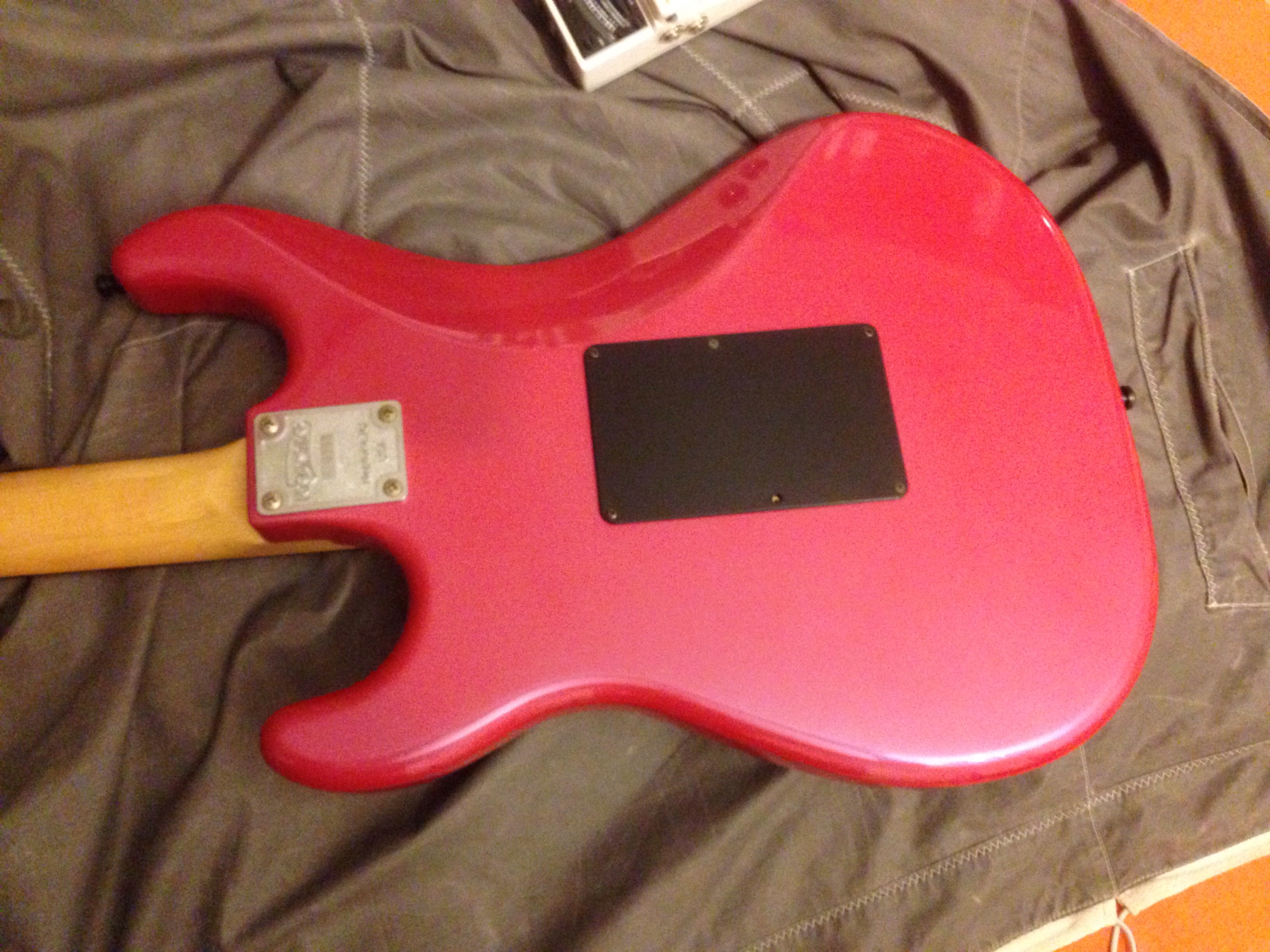

Here' s a picture ofmy Kramer. I removed the three trem springs.

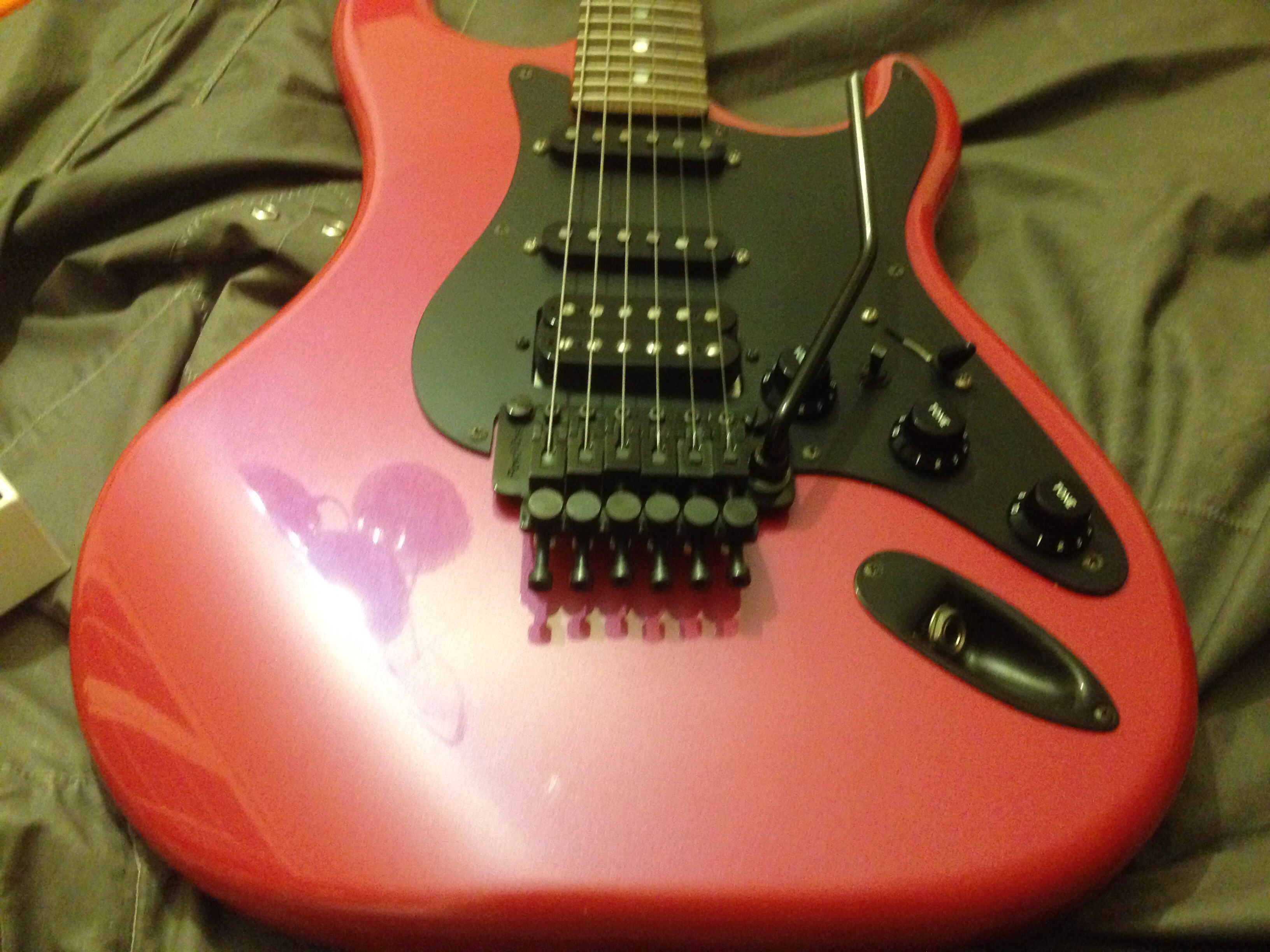

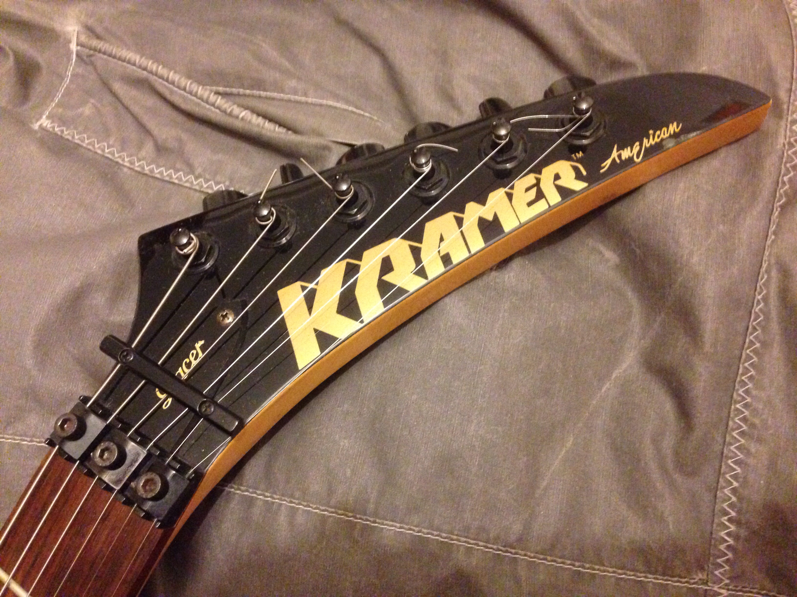

I took it out. Here are some pics of the kramer pacer ( i cleaned it ,soldered one wire that was out, and oiled the seized switch).
Re: Floyd Rose stabilizer
That's a sweet ride !

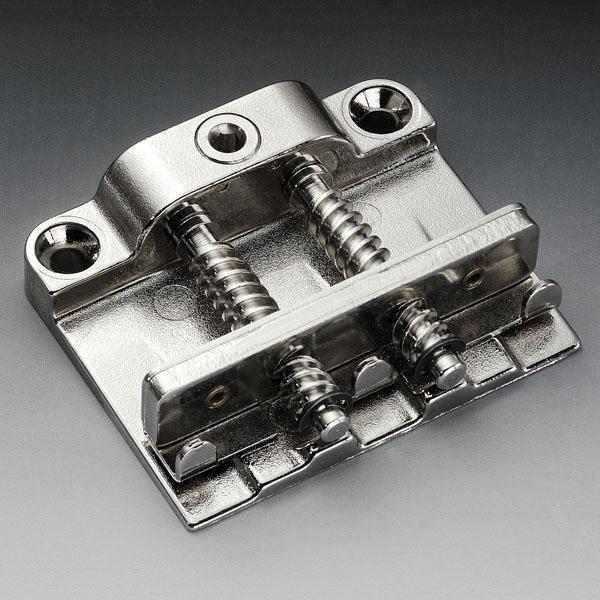

Think you need a Schaller 'Sure Claw'.
- Attachments
- The Urban Myth :)
- Stabbliser.PNG (369.28 KiB) Viewed 7398 times
- Schaller 'Sure Claw'.
- Schaller - Sure Claw 73___377.jpg (63.8 KiB) Viewed 7398 times

Interesting. I checked youbtube videos about that Sure Claw, enjoying discovering guitar gadgets I don't know about...metatron wrote:Think you need a Schaller 'Sure Claw'.

But a Sure Claw is for setting the springs' tension easily, which is different from a tremsetter (hipshot). Am I correct?
