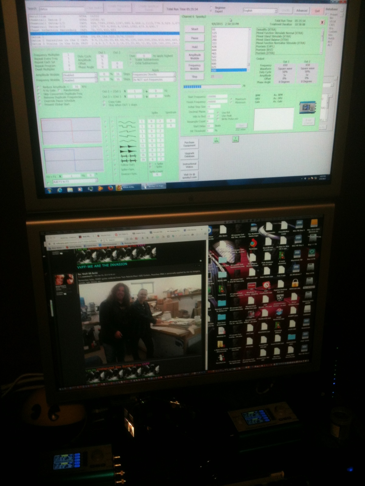

Posts: 10150
Re: Wolfi RR Build
So many shortcuts on that screen!!! :shock:
Tom, do you have some other "Jackson" projects on the horizon or did you have to buy x amount of decals?
